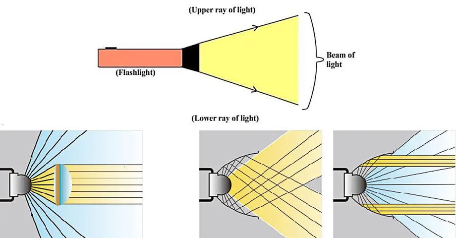

1. Light beam of the torch
The light source illuminates the object by propagating light from the medium, and many tiny rays of light are generated in the process of propagation. Usually we can see the light from a window in a shady room, or the sun's rays from a dark cloud after a heavy rain. Many rays of light come together to form a beam, and all the rays in the beam can be parallel to each other.
Light can be spread out from a point, making the light wider and it can also be directed to a point from different directions. The light beam of the torch is diffused from the center of the torch to illuminate the object.

3. Torch Reflector
The LED light of the torch can illuminate further or larger area through the reflector.
Most of the spotlights and floodlights we usually say are produced by reflectors with widely different beam profiles.
The reflector generally works by its shape and surface texture.
3.1 Reflector shape
The larger the diameter of the reflector, the longer the reflector body and the farther the light it reflects will be projected, which is more suitable for long-distance focused lighting.
The smaller the diameter of the reflector, the shorter the reflector body, the wider the reflected light, and the more uniform the body surface can be illuminated, which is suitable for close-up lighting.

4. TIR Lens
Here we can learn from the wiki that there are three types of lenses: Flat lens, Aspheric lens, and TIR optical lens.
There are two types of lenses related to the optical principle of the torch:
TIR lens: It has a total reflection paraboloid itself, no additional reflector is needed.
Flat lens: The lenses configured in front of the reflector are all flat lenses.
Olight's products using TIR Lens are: Warrior 3, Seeker series.
