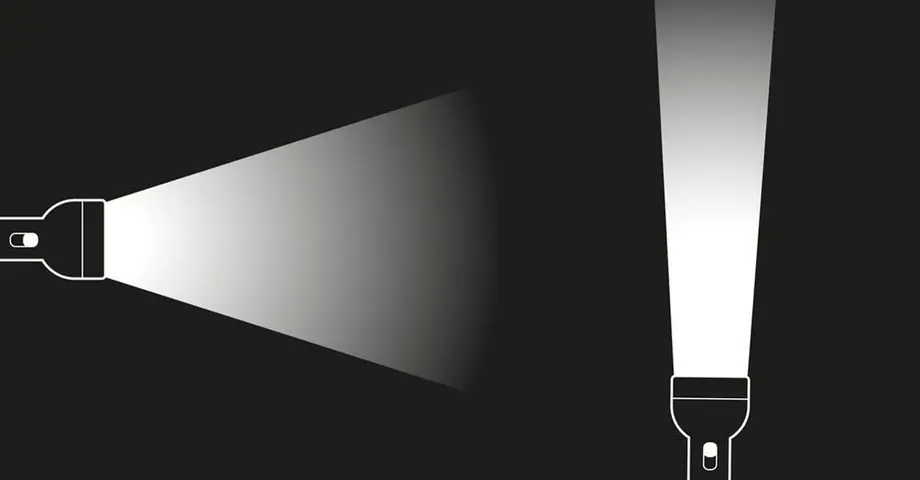

1. What is the difference between a spotlight and a floodlight?
The main difference between a spotlight and a floodlight is the beam angle, sometimes also known as the beam pattern. You can find out more about this here: Torch Light Beam Principle.
The beam angle is a measure of the angle formed between the brightest point of the light and the corresponding points on either side.
Larger beam angles result in a wider aperture across the surface area and smaller beam angles indicate a narrower beam.
Those narrower beams are usually called spot beams and have a beam angle of no more than 45 degrees. These beams are more focused and easier to point and control.
Those beams with a wider angle are considered flood beams, which can travel up to 120 degrees. It can illuminate a larger space with the same wattage and lumen output as a spotlight.
