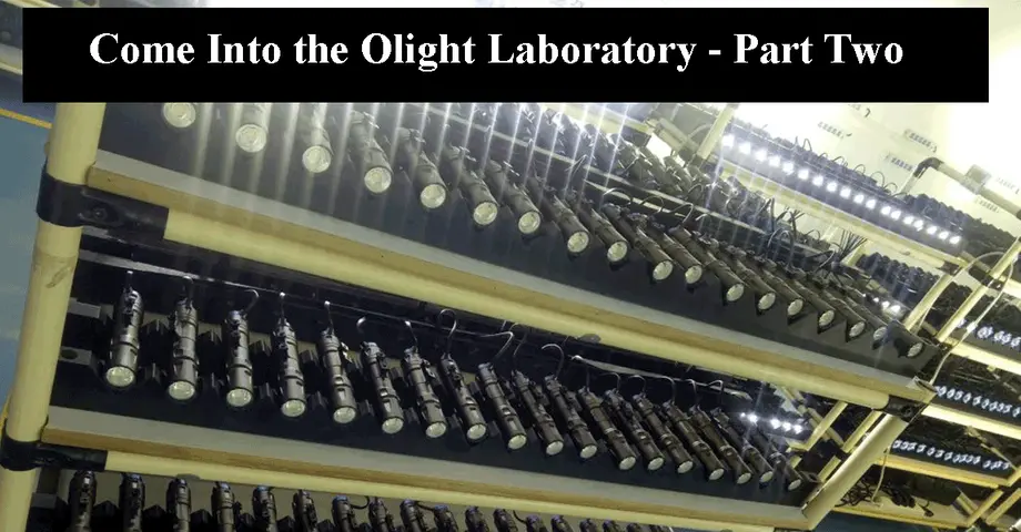

Test Before Leaving the Factory
In order to achieve a satisfactory passing rate, Olight torches are subjected to various reliability tests on a sample basis before they leave the factory. One of the most important tests is the 'aging test'. But why do we need to do an 'aging test'?
Aging Test
There is an indicator in electronic products called product failure, which often occurs at the beginning and end of a product's life. Product failure is similar to human illness, as we are prone to various diseases when we are young and old. The aging test of the product is to let the product enter the healthy and prime period as soon as possible and avoid the early stage of the disease.
Olight torches are subjected to 100% charging and discharging aging test before leaving the factory, the process of charging and discharging aging is as follows: charging to full charge → charging check (check charging voltage, charging indicator, charging time, whether the charging process is normal, etc.) → aging (discharging time according to the model runtime) → discharging check (check torch temperature, switching, dimming, discharging time, whether the discharge process is normal, etc.) (etc.) → charging to shipping voltage → appearance and function check.
Through aging tests, we can check for defective products or devices and then further screen out failed or changed in value products, finding out quality defects or hidden dangers of products, eliminating early failures in products before normal use as far as possible, and fully guaranteeing that the products that leave the factory are of good quality. So you can believe that every torch that comes into your hands is a guarantee of quality.
