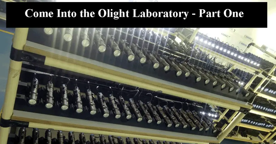

Olight has always had high demands on the quality and performance of its torches. We always uphold a professional and rigorous attitude to make good products of high quality. This is the reason why we have the courage to promise our customers a 5-year warranty!
Olight torches undergo a series of tests in a simulated harsh working environment before leaving the factory, so that the hidden problems in the product development and production process are exposed in advance, fully guaranteeing that the product sold to customers can withstand the tedious trial and test of time.
Today, I would like to take you into the Olight laboratory to see how a good torch passes the test.
