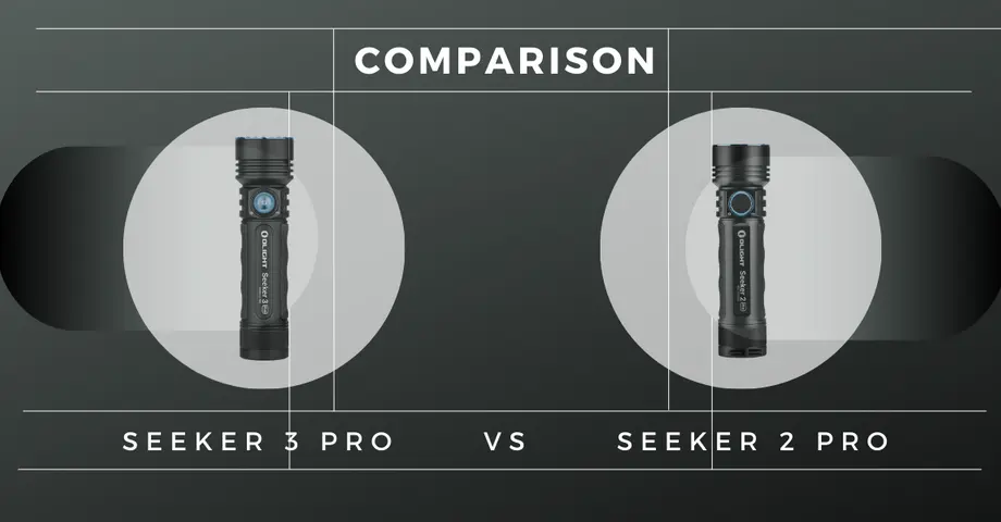

In a previous article we compared the similarities and differences between Seeker 3 Pro and Seeker 3. Today we will continue to compare Seeker 3 Pro and Seeker 2 Pro. They are both hot sellers in the Seeker series but what are the differences between them. In this article we will introduce them in detail to guide your better purchase.
Again, the comparison will consist of four parts: Basic performance、appearance,functions,and other details.

As far as appearance is concerned, Seeker 2 Pro and Seeker 3 Pro are also very similar. Basically, no major changes have been made. Below is a comparison of the two products from the front and the side view. Although at a glance they appear to be the same, there are some subtle differences that can be noticed on closer inspection.
First is the side switch. Seeker 3 Pro equipped with a rotary knob switch that can be rotated 360 degrees whereas Seeker 2 Pro equipped with a simple side button. The newly adopted rotary knob switch on the head allows for smooth adjustment between brightness levels, making it more intelligent and functional than the Seeker 2 Pro's buttons. The second is their bezel. It is clear from the picture that the bezel on the Seeker 3 Pro is a little sharper than that on the Seeker 2 Pro and would be more suited to tactical needs. Third is the location of the lanyard hole, which is on the back of the Seeker 3 Pro and on the front of the Seeker 2 Pro. This is probably a detail that people tend to overlook. The last point is the High Performance LEDs. Seeker 3 Pro uses 4 high-performance cool white LEDs while the Seeker 2 Pro uses 3.
