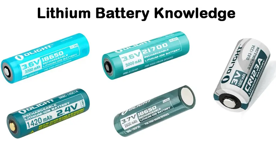

Types of lithium batteries commonly used in Olight
1. Olight Lithium Metal Batteries
(1) Lithium manganese battery: 3.0V, e.g. CR123A
(2) Lithium iron batteries: 1.5V, such as AA and AAA batteries
The above two types of lithium metal batteries commonly used by Olight are cylindrical and non-rechargeable.
2. Olight Lithium-ion Batteries
(1) Lithium-ion batteries: 3.6/3.7V, cylindrical in shape and structure, such as: 10400, 14500, 16340, 18500, 18650, 21700, 26650
(2) Lithium polymer battery: 3.7V, the battery shape and structure of the square, the use of this battery products are: Open 2 penlight, PL Mini weapon light.
