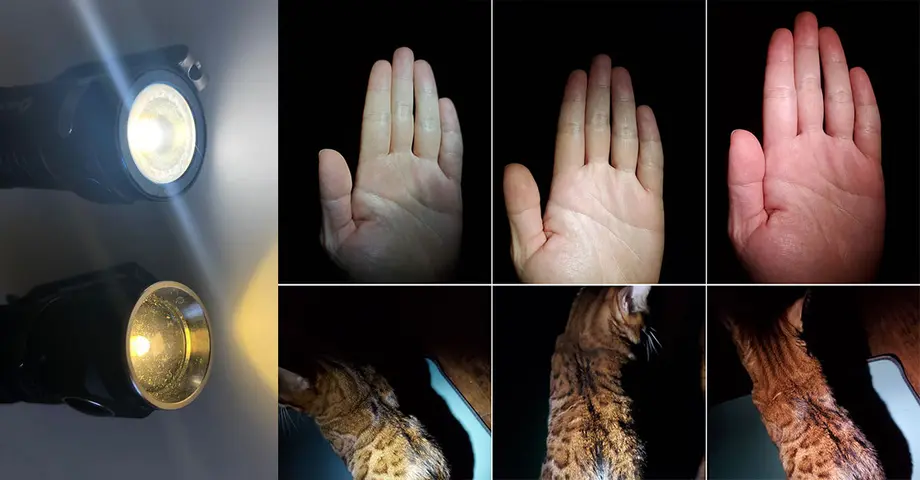

The colour an object appears to be has as much to do with the light shining on it as it does with the light the object itself chooses to reflect.
The Colour Rendering Index of light refers to the quality of the light it emits, i.e. the quality of the light that shines on the surface of the object.
For example: the higher the CRI of a torch, the more people's eyes can see the colour of the object itself. People may therefore prefer a torch with a high CRI.

A colour rendering index (CRI) is a quantitative measure of the ability of a light source to reveal the colours of various objects faithfully in comparison with a natural or standard light source.
It is defined by the International Commission on Illumination (CIE) as follows:
Colour rendering: Effect of an illuminant on the colour appearance of objects by conscious or subconscious comparison with their colour appearance under a reference or standard illuminant.
